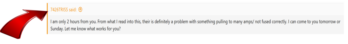

I am only 2 hours from you. From what I read into this, their is definitely a problem with something pulling to many amps/ not fused correctly. I can come to you tomorrow or Sunday. Let me know what works for you?
7426TRISS,
What a generous offer!!!!!!!
Thanks for offering to help out locally(or at least semi locally)
This man is a ROCK STAR!! I sure hope this works out and the problem is resolved. I see a few cold beers needed once this is done.
Dewey
Wow, that is an awesome offer, and I really appreciate it. But I do think if I bypass the battery fuse and put individual fuses on the 3 main wires that are connected it, then connect directly to the battery post that will solve the issue. The other thing is, I don't have access to 50amp service where I am, and that is when it occurs. Let me make that change, and I have a 5-day camping trip with the RV in mid-June. If the issue is not resolved I can possibly pull the trailer to you, and have you trouble shoot it. Does that sound reasonable to you?
Dewey
7426TRISS,
That is awesome for sure. But I think you are right about too much current feeding into the single 40-50amp fuse. If I make the change that I mentioned, and it does not resolve the problem then I will make a trip to him and work on it.
