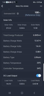

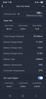

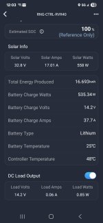

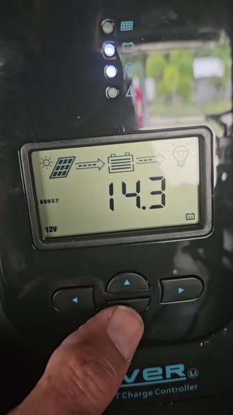

The picture would be great.I can get the controller screen with just solar as it sits now, but I don' have access to 50amp close to me. So, removing the box fuse and put individual fuses on each of the + wires/cables (6G & 8G) that are coming from the + post. That would be better?
Hey Dewey, thanks for the effort!Here is a link to the video I took scrolling through the Renogy settings while on solar, not connected to 50amp. I think that is what you are asking for.

Dewey, thanks but that isn't helpful.I have this one, but I am pretty sure it was when the fuse was blown, and the battery was drained. It probably doesn't help you much. I can go to the RV and take a picture. I thought the Renogy app would give you more info that just what the monitor shows. I really think that "DC Load" is a reflection of the monitor in the coach, but I could be wrong for sure.
I see an Issue with the battery monitor however this is not the root casue of the issue. the battery monitor shows 12 Ah and 12% that would mean it is still set up for the 100Ah battery that was originally installed and not the new 280 Ah Battery. I will check my Battery termanail fuse when i get a chance to compare sizes. I agree that that size sounds low. I have the 2022 36v11.I have this one, but I am pretty sure it was when the fuse was blown, and the battery was drained. It probably doesn't help you much. I can go to the RV and take a picture. I thought the Renogy app would give you more info that just what the monitor shows. I really think that "DC Load" is a reflection of the monitor in the coach, but I could be wrong for sure.
Yes, at the bottom of the phone app. I will get one with the system on solar, but I would have to pull the RV somewhere and hook up to get 50amp.Dewey, thanks but that isn't helpful.
A clear picture just like that one, but when the system is operating normally on solar only and another picture just like that when it is plugged in to 50 amp would be extremely helpful.
What exactly to you mean by “DC Load” is a reflection of the monitor in the coach? Are you talking about something on the phone app?
Yes, that was a picture of the monitor before I replaced it with the 280Ah battery. Let me know what size fuse you have because I think the equipment is the same.I see an Issue with the battery monitor however this is not the root casue of the issue. the battery monitor shows 12 Ah and 12% that would mean it is still set up for the 100Ah battery that was originally installed and not the new 280 Ah Battery. I will check my Battery termanail fuse when i get a chance to compare sizes. I agree that that size sounds low. I have the 2022 36v11.
