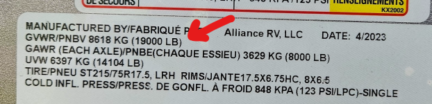

Another benifit is you move to 8k vs 7k axel.
Yup! And we travel light so the extra beefiness is a welcome bonus for durability. Someone posted on Facebook that the GVWR goes up to ~19k with the IS and DB on the 2025 340RL. I cannot wait to get this rig!
Yep...ours moved to 19k on our 2023 340RL
