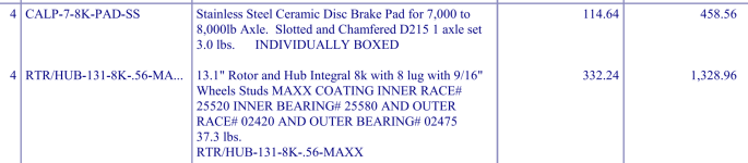

They sent me a set of Kevlar pads, also Deemax, that I have to have installed. Did you go with another brand? If so, what did you go with?
They sent EVERTHING to do entire system over. New pads were still DeeMax, but they had to also replace all 4 rotor/hub as well. Hard to really see the damage in the image below, but after inspection (and images sent to DeeMax) the decision was to replace with all new parts vs trying to turn the rotors, as the damage was so deep, turning wasn't a valid option.
Holy crap. That is significant.
