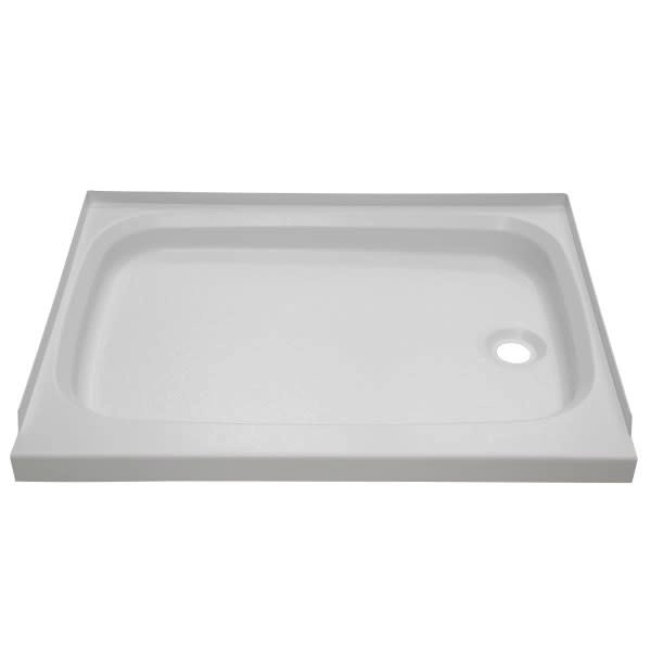

I just noticed that I did not post the picture of my shower pan, once I removed the shower walls. If your pan is cut like mine was, then there is no waterproof barrier (The Pan LIP) to backup the silicone if it should fail. It goes right to the wood paneling and below.
The least expensive thing to do, is to dig out the silicone there and see if the pan area that my picture shows being cut, is actually cut or notched. If it is not notched or cut there, then you will be fine. Fill it back in and call it a day.

It is cut there. On both sides of the frame. It was on my fix-it list and the Blue Compass guy thought he fixed it by caulking the dry side of the frame and didn’t bother to look inside the shower where it actually gets wet.

It’s not a crack. It’s an 1/8” cut from a saw. Maybe a table saw, maybe a skilsaw. And that cut is at the junction of the wall panel and the shower pan.
Clearly we are talking about two different issues, do you not see the hairline crack in the shower pan?
I agree w Bryan,,,clearly the pan has a hairline crack, that, imho, is warrrantable,,,and Imho,,,the major concern moving forward of future problems. Worked for 45 years in commercial construction, and there are firms that specialize in,,,in place fiberglass repairs. Recommend you find one & get their assessment of the hairline crack. Believe the “ notch is solvable & they can probably help in the notch areas as well for assessment, advice, and suggestions. Good luck,,,👍🍀

The other thing, is the wall panel is slightly crooked. You can see how it is flush with the shower pan in the corner at the left side of this photo. But it has a gap at the corner with the notch so there’s no overlap. Kevin with Alliance is saying this cut is supposed to be there to allow the door frame to sit tighter against the wall. Is that possible? Thank you all for help in the matter. If caulk is sufficient I’ll do it. But what the one guy at Blue Compass said makes sense.IMG_4308.jpeg
So the pan is notched and like mine was. There is no reason for it to be that way in my opinion. You now know what you are dealing with and have a choice. Since there is no water damage, then the easiest is to silicone it back up.

The other problem I haven't mentioned. I circled the area, where the shower door track is joined. The side wall track doesn't extend to the base...the floor track does and most likely has no END CAP. Mine had silicone inside the track to seal the joint. If the shower pan lip had not been notched, then everything would have been fine. However, the water in your bottom track can possibly find it's way out and down that notch (On both ends). I am pretty sure this problem is on both sides now. Make sure you look at how the tracks are joined.

If it’s a Lippert pan, it looks like it’s intentionally designed that way.
I'll be darn...interesting....I am going to call it bad design when paired with a shower door track system with no end caps on the bottom track. If silicone fails at the end and inside of the track, it will be hard to detect.
