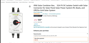

I received this recall on my 370FB. I did the repair myself and just sent them pictures of the repair having been made...hope it helps. I also put a breaker just before the charger, so I could turn off or isolate the panels, should I ever need to trouble shoot an electrical problem
