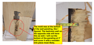

Ok..so I pulled my shower apart on my 2023 370FB. The attached pictures should tell the story of what I found. Hopefully this helps others consider whether or not they want or need to tackle a rebuild like I am. Since my rig is 3 years old, I would probably only get half price for it. No sense taking a haircut, to only get a new model with the same possible issues. The jury is still out whether we will see complaints on the Instant hot water heaters and full shower inserts. I am thinking those full inserts are going to be taking a lot of stress, based on the framing choices and technique I see here. Fixing the issues myself, will be much cheaper. Hats of to all of the DIY members!! I only have 3 hours into this so far. Now it is time to price out some options. I will share the costs, when I nail them down. Any ideas or thoughts will be appreciated.

On the bedroom side, I will cut out the bottom 3" of mold, replace it with go board, and throw a piece of Base molding over it. If the problem is worse (I doubt it), then I will re-panel that side with a contrasting panel design.

I have since pulled off all the paneling to the bathroom door, but here is the MAJOR culprit to my leaking shower. I also had the leak at the shower control valve, but here is the MAJOR area. The pictures explain what I found. The bottom line, is that they should have never cut the lip on the pan and they should increased the shower wall insert, to a point outside of the shower doors. I would have known the silicone was leaking, BEFORE all the water damage could happen. It is a hidden point of failure in my opinion.
My plan on the bedroom side is to replace the 3 1/2 " with waterproof 1/4" Go Board and cover with a base trim.
