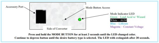

This is interesting, mine was built May 12th and I guess they are calling it a 2026. There must have been a change, and not for the better, in this case. My panel is not the same as yours with the switch!! Mine has a PD9360 Converter, it is located behind the area of the panel and the company says I have to switch it manually on the converter! I am 76 years old and I see no way to get to the controller through the bay door. There is a mass of wires, hoses, and sewer lines in the way!!!! I will send pictures when I can!

I called RVFIX and got a video call and between me and the tech, we pulled the panel forward and I could see the front half of the charger, but the back is where I needed to get to. I found that the bottom of the cabinet in the other half was held down by 4 screws, I took them out and was able to push the floor up from the other side and there was the back!!!!! I put the little "KEY" in and waited for the light to turn BLUE and it is supposed to be switched to Lithium now!!! What a mess, all Alliance had to do was keep the damned switch in the control panel and I wouldn't have lost so many brain cells!!!!!!

I emailed Alliance after we were texting and got this in response. I've sent a follow up asking for the best strategy to access.
Good morning,
Thank you for contacting the service team of Alliance RV. I received your request for converter information in your 2025 Paradigm 340RL. Your unit has the Progressive Dynamics PD9360 converter. The converter does need to be switched for lithium batteries. The tool to push the button is taped to the side of the converter. Please see below. If you have any other questions, please feel free to reach out.
Good morning,
The follow up seems helpful
We are happy to help! The converter should be directly behind your breaker box/fuse panel. Most likely, you will need to remove that to locate access to the converter.
