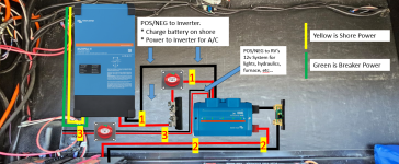

To power both legs (enabling the AC units), the best solution is to starting from scratch. The basic concept is you remove the incoming power line from the circuit breaker and move that to the "incoming" line on inverter. Then run a new line from inverter "out" back to same spot on the circuit breaker. Attach your battery back to the "DC In" posts and done. Of course, there are fuses and cut off switches involved, but that is the concept.
Here is a drawing of a system I installed on a friends Grand Design. The "3" line in this drawing just goes off to nothing, as I didn't have the correct image of his compartment with the 12v distribution bus.

Thank you for posting. I appreciate you sharing this with me! I figured that was the best option. I'm trying to limit work I have to do and would like to use the suppled system but I realize it maybe isn't the best solution but I figured with the Chill Cubes, I don't need a lot of power. I really appreciate you posting this.
