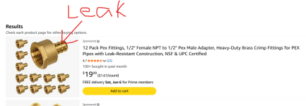

I have a 2025 delta 234rk. First time using the black tank flush yesterday and the pex pipe came disconnected from the near the black tank flush port behind the convenience center panel in the pass thru. What is the trick to removing the panel to gain access to reconnecting the pex to the other side of where the hose connects on exterior of trailer? I don’t see any videos of anyone doing this online.
I don't know if this will help you, but I find the "Clamp ring" style of pex crimping tools, to be the easiest to work with on my 370FB. I only need 1 hand.
The ring crimping tool is just too big to get in most tight places and needs 2 hands.
Attached, is the backside of the panel. It looks like the circled area, is screwed to some framing. The 3rd pic shows a corner piece that may need to be removed.
I would think you could fix it, without removing the panel. The flush port is threaded. Cut the pex on the back, where you can fix with a 1/2" coupler. If I am understanding what you are asking.
@RockDr896
The pex still has the female thread attachment on it. The male end is still attached to the exterior wall but behind the panel. I assume all I need to do is remove the panel and reattach but haven’t seen anything online about removing the panel to gain access and wasn’t sure if this was recommended or not. I didn’t want to cause more problems by doing this and not knowing if this is smart to do or not.
A picture would help...but I think you are saying the leak is after the threaded black flush threaded fitting (Pic #1)?
OR,,,is it the other side of the female Pex fitting, that transition it to the female side?
I am not a plumber by trade, but I would cut the pex pipe, where you can eventually couple it together
Remove the damaged piece
Go to a hardware store and buy what you need. I took a stab at what you may need, but nothing beats going and making sure the threads work.
If you don't have Pex tools, then you get to buy a new tool...LOL.
If this isn't in your comfort zone, then a mobile mechanic or plumber will make short work of your issue! I think a plumber would be quicker response and have the fittings on their truck. Just make sure they carry 1/2" pex on their truck, before hiring them.
