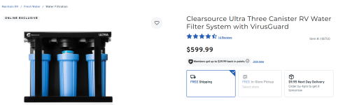

The incorrect adapters (not NPT to GHT) were sent but will be here on Sunday so just about done; not that this was a time intensive project. Anyhow, the cost savings are remarkable. Saved ~$500.00 compared to the below and I did go with 3/4" full flow fittings so it might be a little better. I am still using Clear Source virus filtering media.
I may switch to Pex once I decide where to mount it in the rig.
