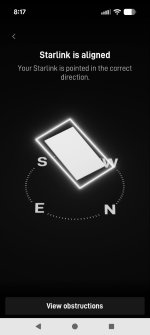

Waited till we knew it worked ok before we bought the gen 3 adapter from FPB. Got the new adapter, got it all rigged up, put it up on the pole and set it into the mounts. Soon as the system connected, I turned the pole/dish to point the right way, and it said the "TILT" was off. Now, I am VERY fussy with leveling our rig, and it's in our yard, LEVEL 100%.
I was baffled as to why the tilt is so far off. I pulled the pole out of the bottom bracket, and set it on the edge and the TILT was corrected.
So I had to figure out why and I put a level on the ladder. Side to side, front to back, and the LADDER it self was OFF front to back, as if the horizontal brackets attached to the trailer were of different lengths. The ladder was off just enough, like 6 degrees, to throw off the tilt on the dish, which only has a 5 degree margin of error. Yes, that 1 degree was enough to cause a poorer signal.
Solution: On the flag pole buddy lower mount, you can adjust the "tilt" by losing up the screw, and moving forward or backward and locking in the next set of teeth.
This fixed my issue. So, when at a camp site and we are off level just a bit (never :p) I can adjust this again provided we're also facing a decent direction.
Using my yard isn't the perfect test but it did give me the means of fixing the ladder being off that much.
