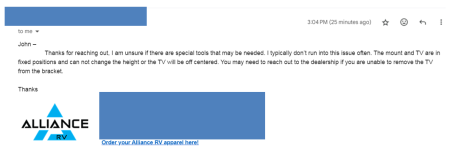

I hope you're right. Even though this is the first issue that I dont feel has truly been addressed for me (out of 3) it definitely feels like the buck is being passed. I have more pics with my endoscope trying to hook the lever and how my fingers cant even get close to reaching the lever! I know I am not the only one with this problem either... there are 9 ports on the back of this tv and NONE are reachable. People still use DVD players, satellite dishes and even games.... but right now, not on this tv. If I am forced into playing with the grandkids... I'll really be pissed! ;)

So disappointed in the lack of help on this one from Alliance. Just little bits of information could save me time and trouble.. not to mention a few scratches on the wood and tv...

That is an interesting question though - I dont think my satisfaction outweighs the disappointment I have in Alliance. This mount appears to be a pretty standard mount as I saw it in other posts... but not close up. Had I been sent a picture of it - I would have known which direction at least to push it and how tall to make the tool (I made 3 of them).
