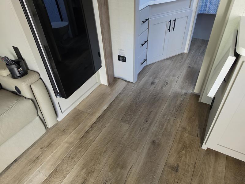

The issue just happen on our 23ML. I was able to temporarily fix the position with longer screws. But, this is no holding the firg in place. I believe a cabinet rebuild is require. I am looking for recommendations from others with the same issue.

Funny I was just looking at our fridge in the new 252RL and it's mounted with a pretty good tilt back. Makes the doors close on there own but it's a little excessive.

Can't really tell from this pic but it's mounted slanted pretty badly. Another Junk built trailer. LOL
