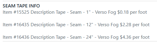

Whatever you decide to do, you can order seam tape from Alliance that matches the interior of you rig. This may help you in the future, if new holes are required and old holes need to be covered up. Perhaps it will give you some peace of mind, concerning the finishing stage.
