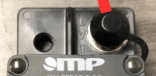

There is a problem with the diagram that Alliance provides for this upgrade! I don't how big a deal it is but...
They show that the silver terminal of the existing breaker connects to the battery and it should be the copper colored terminal.
Then they show the same mis-wire on the new breaker.
The parts are clearly marked BAT on their respective terminals.
When installing this upgrade use the guide as a guide but pay attention to the part mfg markings.
