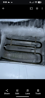

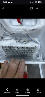

2024 Avenue with a Furrion 16Cf d side by side is not cooling. purchased in September of 24 and my wife heard something pop and the lights flickered and then we smelled some wires burning. fridge has been working on and off cooling and freezing then not cooling and freezing. pulled the panel in the freezer and this is what we found. coils frozen up not allowing cooling air to circulate the freezer and refer. i think the defrost is burned out. see pictures. this is suppose to be frost free but obviously it's not working correctly. anytime else have this problem?
