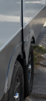

I thought I'd have to order, but my local dealer has a 30BH in stock and is offering what seems to me to be a pretty good price. I'm close to pulling the trigger, but I have a question that for a lack of a better term would fall under fit and finish?
On the non-camp side, part of the fender skirting is on the slide. When closed, that plastic skirting is over an inch further out than the part mounted to the sidewall. The slide seal is likely pushing it out some, but that much seems excessive? Will that settle in over time? Or something that needs to be fixed before I pull away with it?

A picture or two of your fender concerns might help this group evaluate your concerns.

I'll see if the salesman will take a picture for me. Unfortunately, the dealer is 1-1/2 hours away and I didn't think to take a pic :confused:

Seems excessive? I'm a little concerned the wind load would rip that fender skirting right off

If the slide is closing tight the fender is just aesthetic (for show) The front and rear fender are never going to be totally flush. They are attached to 2 different panels that are not on the same plane. I don't consider the fender a problem.
However I agree it would be wise to have a pro inspector look at the unit.
Well, that would certainly be a result of the design. As others have said the fender is on two different plains, so it will never align. I would suggest that you ensure that it is adequately fastened on the leading edge to protect against the air flow .
