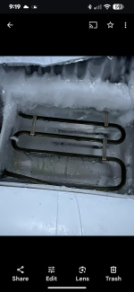

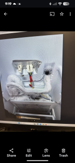

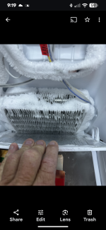

we have a 2024 32rls Avenue with a furion 16. cubic foot side-by-side refrigerator 12 volt. about a month ago we heard a pop and the lights flickered inside. the refrigerator worked and was keeping things cold up until recently. the refrigerator was not getting cold and so we emptied the freezer and found this. I'm thinking the defrost is not working or not doing its job. maybe that's what the pop or sizzle sound that we had heard and we smelled wires burning but it went away. anyone else have issues like this? the above post seems like it's the same thing but a different brand.
It very well could be the same “type” of issue, but your connections do not show any signs of melting as called out on the other post.
That said, maybe your issue is on the other side of that pass thru connection.
If you heard a pop and smelled burnt wiring, it would warrant gaining access to the other side of that connection for visual inspection and or repairs. Obviously, your defrost circuit isn’t working, the million dollar question is why?
Please keep us posted on your findings.

having a service tech coming out next week to diagnose. will update when we have some answers
