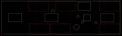

Solar panel placement, red boxes are the panels, white are existing roof components.

- 200w 24v Rich solar panels, removed factory installed 12v panel. 2 serial 3 parallel panels for maximum 87V and 17.8A

- I have room for 2 more solar panels if needed. Going with 250w panels might have fit and given more watts per foot, but the cost jump wasn’t justified for my needs
