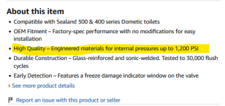

Water Valve to flush/fill toilet.
Silicone Grease fo rubber seal
You can of course buy the lower cost water valve, but I HATE water/plumbing and don't want to save a few $$ to have water damage later.

You done right Jim. There are cheaper valves but it's best to use the Dometic brand. IMHO
