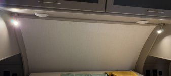

Kathy and I installed our LED reading lamp today. It turned out to be fairly easy install. Started by removing the factory LED lamps, a twist of the bezel and the bezel came right off. We wanted to place the new lamps in the corners which worked out great. The bottom of the cabinet is an open space. The factory wiring had some slack which allowed the wires to be pulled through the factory holes. They factory used Wago connectors but they had no spa slots. So, we purchased 5 slotter from Lowe’s and after adding the new lamps we have a spare slot. I did enlarge the factory holes to pull the Wago connectors out to be replaced. Check out the pics for some of the install process. Adding pictures shortlyIMG_4521.jpegIMG_4524.jpegIMG_4516.jpegIMG_4519.jpegIMG_4530.jpg
