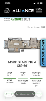

Appreciate the passion on the subject. When buying the 32RLS the reseller sales rep AND the manufacturer rep said 3/4 ton is more than adequate. I said I don't have the truck yet, guide me correctly. They still said 2500. Review of specs (mainly payload) and your input here on this forum guided me to 1-ton. I did test drive a dually. Can’t lie, it was very cool driving. As the truck is also my daily driver, I went SRW. Things like fitting garage and parking have nothing to do with towing - but was important to me. Grateful for all the comments. Thank you!
