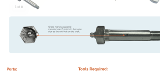

The Cre 3000 was a mess, which I did have a gut feeling it would be. Of the 14 wet bolts, I had 5 that would not take grease and required disassembly and cleaning. I had one leaf spring that had the leaf retaining clip (?) dislocated. I was able to move it back into place, but I will likely try to find a replacement because I don’t think this will remain in place.
