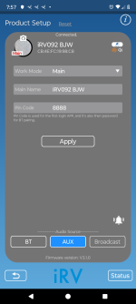

Solution: First you need to download the iRV Audio app for Android or Apple, and start the app
Second: you will see the speaker name appear in the list after a minute or two. Don't try to connect to your phone yet.
Third: In the bottom right of the app you will see a "Setup" button. CLICK IT
Fourth: A screen will appear and the third field will be the current PIN Code (if you want to reset to default enter 8888) and click APPLY
Last: Went to my TV, Choose Blue tooth devices, add and entered the pin 8888 and it successfully connected
