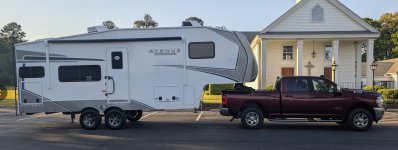

Yes. I had the same issue understanding the clearance issue until it was setup at General RV and saw it with my own eyes. I have a Pullrite auto-sliding hitch that is attached to rails in the bed of the truck. I was looking at lowering the nose of the RV by 1 hole on the Curt Rotaflex pin box to get the RV more level.

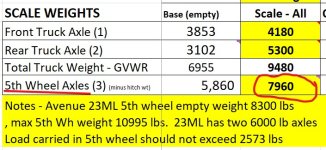

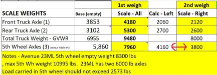

Obviously the radius of swing doesn't change but (#1) raising the hitch by 1 hole (1 to 2 inches) results (#2) in lowering the corner metal plates on the RV the Curt hitch attached to by 1 to 2 inches (see picture). This leaves me with very little clearance between that lower corner of those plates that stick out below the hitch (see yellow box) and the inside of the bed (remember my RAM 2500 has ramboxes where the width of the bed is 50 inches instead of 66 inches.) The clearance is only about an inch when on level ground and making a tight turn. On unlevel ground where the RV is not on the same plane as the truck, the clearnance gets even less. I'm not willing to risk having a 'collision' between the corner of the metal plates and the inside of the truck bed. Ramboxes make it very difficult to get a 5th wheel hitch setup properly due to clearance issues. I do think I'll go across a CAT scale again and put the RV front axle on one scale and the RV rear axle on the rear scale to see what difference in weight exists before I decide what to do next.
