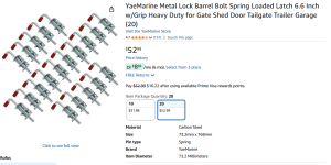

I decided to make my 370FB basement walls quick release. Removing all those screws to get at something is a pain. Not to mention they were rusted. Anyways, here is what I did. Now I can pull 4 pins and remove a panel if needed. I was going to make them swing open, but at 6'2", I just need them out of my way when working in there.
I used shelving rails from Lowes and simply screwed them to the metal angle. I had to enlarge the pre-drilled holes, but it was fast to do. Walls are as tight as when they were screwed.
