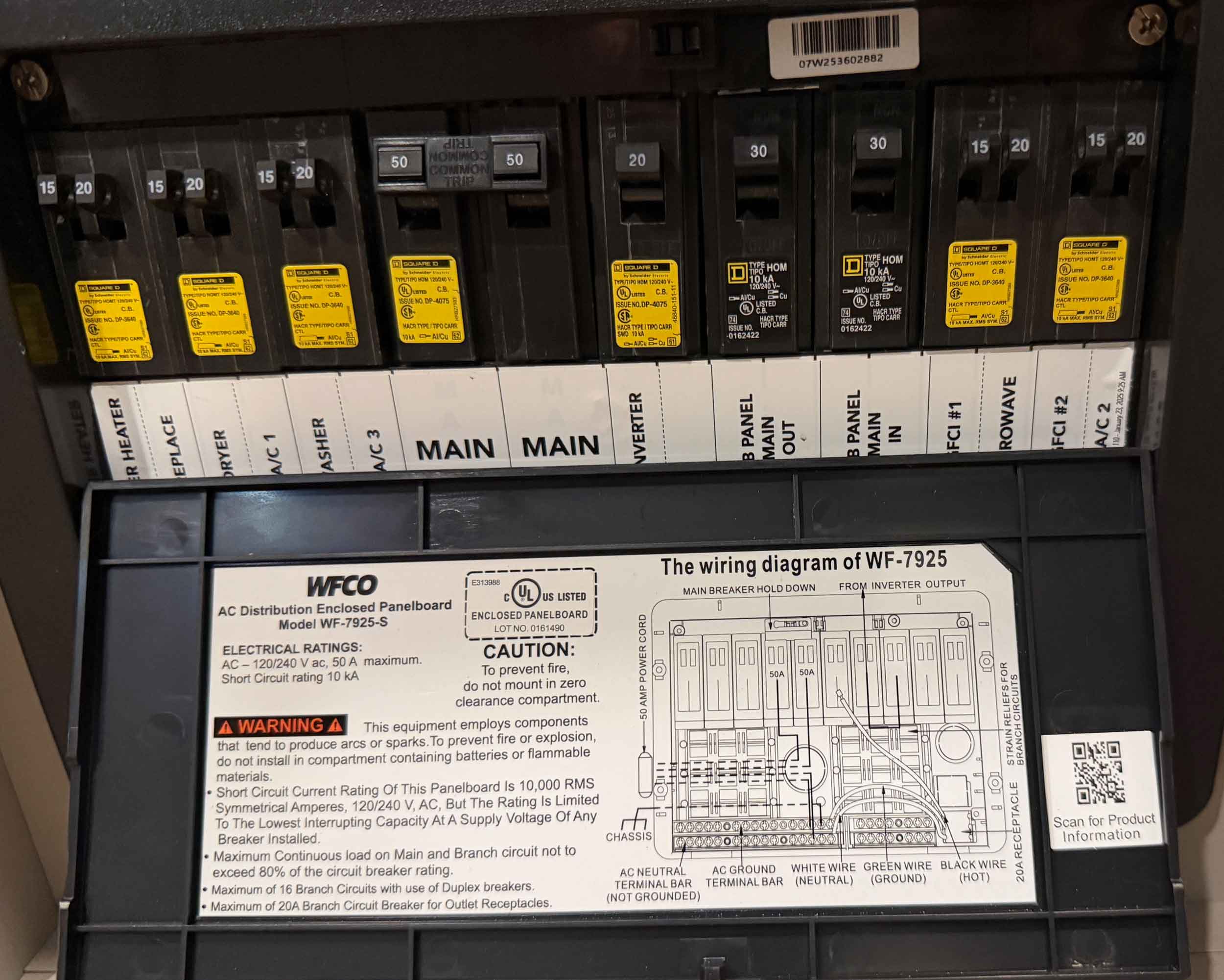

Power is already run from your main panel up to the front of the camper and from there back to the main panel.
Those two 30 amp breakers are the inverter prep ones. Everything to the left of them runs only on shore power or generator. The four breakers to the right are the ones powered by an inverter if installed via Alliance inverter prep.
So, if you want to install giant batteries and a big inverter and cover the roof with solar panels, you can do all those things, but you still won't be able to run those appliances on the left side of the panel. I mentioned in my related thread that I moved the factory generator prep out of the way but kept it accessible in case I ever want a much bigger inverter (or two) to run the whole camper.
