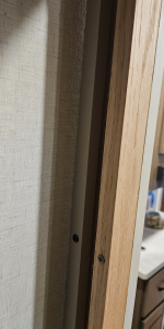

The Norcold DC refrigerator in my 2022 32RLS is slowly but gradually getting ready to fall out of its wall cabinet!
The attached pictures show the Leaning Tower of Norcold and the closeup shows a typical screw attachment that has pulled out of the cabinet face frame.
A few weeks ago I noticed a blemish in the refrigerator cabinet face frame near only one screw point and didn’t pay much attention to it. But now after some bumpy road trips the cabinet face frame now has 3 failed anchor points and the refrigerator is noticeably leaning forward.
There are multiple screw anchors in the upper refrigerator compartment that show signs of pull-out. The lower ones in the freezer compartment look like they are securely attached.
Behind the cabinet particle board facia, there is a strip of solid wood blocking on both sides of the opening that I believe is the intended target for the refrigerator mounting screws.
In the closeup of one of the failed screw anchor points, you can see the tip of the screw! It wasn’t long enough and never penetrated the solid wood blocking.
The mounting screw heads are inside the refrigerator compartment. I’m camping now and don’t have an ice chest to empty out the refrigerator and take my time to make a permanent repair. I’ll just do a temporary quick fix with longer upper mounting screws.

I would remove the screws, drill out the holes to allow a 1/8” or 3/16 hardwood dowel to be inserted. Cover the dowel with epoxy, I use epoxy that sets in 5 minute. drill a pilot hole for your screws and reinstall the screw. The damage I would use a clamp to bring it flush with cabinet, tape both sides with masking tap, mix some epoxy with sawdmust to thicken to a putty and fill the damage. The tape will probably stick so you will have to remove carefully sanding as small an area as possible. you might also use a white epoxy And find a paint to finish. Please excuse mistakes I’m not good using my phone.
No way to simply fix the pressed paper "wood" they use to screw the frig into. We just fixed this on our 2023 340RL a few weeks ago by removing the frig and taking off their wood frame and replacing it with oak trim (see the blue arrows) Solid as a rock now!! We also took the opportunity to build the floor with REAL support. You'll be shocked to see how little support is there holding that heavy frig up. :cautious:

For a temporary and “emergency” repair, I removed the upper most mounting screws and replaced them with slightly larger hardware.
Before a planned 2025 Summer 800 mile camping trip to NY, PA, OH and IN, I did a permanent repair by removing all the exiting mounting hardware and replacing the pathetically inadequate wood deck screws (out 8 existing screws, six were snapped!!!) with through-bolted M6x120mm (about 1/4”) furniture-style hex-head bolts with rivet countersunk hex cap nuts.
That’s not overkill: that’s what is needed to make this permanent repair.

Ours kept rolling out while we were driving. The issue seems to be that they put one line of screws on an L bracket at the top of the thin lining og the fridge to hold it to a piece of trim it is held on with staples......
I added a square extrusion on the top of the fridge and joined the L bracket to it so I now have 2 lines of fasteners holding to it to the thin fridge casing. I then drilled through from the cabinet above and inserted three 10/32 x 3" screws into the square extrusion (I put rivnuts in that).
We also added a foam bumper in the back of the fridge compartment to cushion any movement while driving.
