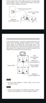

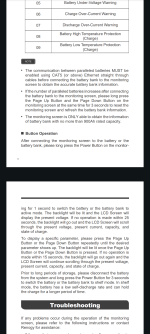

Here is some additional information on getting the monitoring panel to see the additional batteries.1000000503.png
