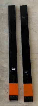

In another thread I posted a "Youtube" of a 2x4 lumber stabilizer idea that was labeled "Too cheap". ๐Ÿ˜œ @Lantley ๐Ÿ™ƒ
Here's my flavor of that idea. It works very well and cost next to nothing since I had all the supplies. Plus, I don't think it looks "cheap"๐Ÿ˜‰.
โ˜‘๏ธ I don't have many dimensions to share. They may be different for your rig anyway. I just eyeballed it. It works well at home on my level slab but has yet to see field tests. A sloping site may be a problem for the length of the 2x4's (mine are 44"). These rest under the upper flange of the frame I-beam. Future thought to be given to a design that can also hook onto the lower flange for extra length.
โ˜‘๏ธ I mortised the 2x4's and pressed in a cutoff ยผ-20 x 4" hex-bolt. If I made another pair I'd offset the bolt towards the outer face for more strength even though these seem to be plenty strong. I used the hex-bolt instead of an eye-bolt because I had the bolt. They also pack away easier without an eye-bolt sticking out.
โ˜‘๏ธ The rubber is not for traction but for durability. The orange was for trip hazard but they're under the slides so...๐Ÿคท๐Ÿผโ€โ™‚๏ธ
๐Ÿ”ฅ๐Ÿ”ฅ๐Ÿ”ฅ One thing to remember is to remove them before retracting the rear jacks. They'd probably splinter and punch holes in the plywood floor. ๐Ÿ˜ฌ I suppose that could happen with commercial ones too.
