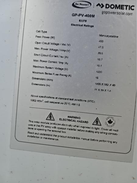

I would take a pic of the label on the solar panel. Should tell you VOC (Voltage Open Current) and Watts and all that. Post here if you can.
Mixing panels can be done. Just try to get the VOC as close as possible so the loses are at min. There are so many different panels out there. You can find another 400 watt panel with the same or close to VOC.
if you add panels are you planning running in a 2 S config? meaning in series to each other. That what I would do.
As long as you charge controller can handle the VOC (Volts open current) Also for each panel when figuring this up add about 5% for them perfect days and cooler weather. The VOC will go higher than what's on that label. You will fry the change controller if you go over the volts.

I also have the 400 watt panel and asked dealer what it is and nobody knows Alliance probably don't even know. LOL
I plan on getting a pic of the label soon.
