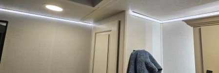

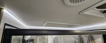

I saw someone on the Alliance Facebook group add LED lights to their bathroom and my wifes loved it. So, I got the parts and 4 days later, I'm done. Had a hiccup with LED lights snapping (my fault..not MFG) so I had to order a LED light connector...2 day wait for Amazon to deliver.
All in all...I like how this tured out. As a bonus, I had enough extra LED light strip, that I wrapped it around the medicine cabinet, doubling the light coming off the cabinet now. If you look close you can see a small gap in the defuser above cabinet, where I brought lights down to wrap them around cabinet.

looks great. how about a link for the lights you purchased. would like to add more light in our 32RLS bathroom also. where did you get the power from?
https://ebay.us/m/yJW5at - these are the waterproof warm white used in the bathroom.
https://ebay.us/m/tekjwu - 10x1m LED Aluminum Channel and plastic defuser.
https://amzn.to/4nHJROr - LED connector if you want to connect LED strips directly vs using their built in red/black wires.
I tapped into the main light switch in bathroom for power.
Oh...one more thing. The LED is continued inside the linen closet, so it is an added bonus of more light in there. My wife didn't want the LEDs on front of the cabinet, so inside was a great choice. Now that they are installed, I have to agree with her, as it looks nice with a break in the lights. The green highlight, is simply showing where the LED strip is on inside of the cabinet.
