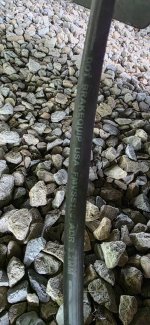

We have a 2026 Alliance Paradigm and are on our third trip. Our first and second trip we took it back to Blue Compass because the brakes did not work correctly. They looked at them and told us they were fine. We are now traveling and we were getting ready to pull out of our camp this morning and saw a brake line hanging. After further investigation it was disconnected long enough to wear the connector end off. Our trip has now been interrupted and costing us more $$ to wait on repairs.
We are very fortunate that there was no accident.

I chalked it up to human error and not tightening it correctly or vibration over time. Now...I have applied torque seal to all those nuts/bolts and I can quickly see if they have come lose. Ours was on the passenger/door side...rear tire.
Do you have any theory on why it was off? We are wondering if it was loose from factory. What side did yous happen? Ours was on the left.

Sure can...I lost a caliper bolt (see image) and that caused the entire disc brake assembly to rock up and back, thereby knocking the brake line with it. Mine is an IS system. I now lean in and inspect my bolts, with the torque seal.

My disk brakes fell off on my first trip. There was no locktight on the caliper bolts. Dexter replaced my rims, tires, and brakes, with no issue. I was lucky the failure happened in the last miles and was able to land it at my storage unit. My F350 can handle the trailer without brakes, with no problem!

Interesting. Like @BryanValRox , I've herd of Caliper bolts backing out, but did not think it was as common as it seems to be on these rigs. I had to have someone else do my bearing repack and it was done at the National Rally by Ramblin Man (who was actually fantastic). He mentioned caliper bolts being both dry and loose is very common on MorRyde IS (mine were neither) and he added blue loctite.

It was on the left side. One completely came off and the other loose. We believe they were hand tightened and not torque. We' took it back to dealer Blue Compass twice with complaint of soft to no brakes. We had then bleed them twice. They said everything looked good and have our truck checked. Our truck 3500 Ram dually was just fine.

Its independent suspension and electric over hydraulic.
Ours wS the same rear tire on passenger side.
