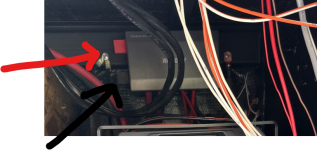

I have to honestly say I am extremely unsatisfied with the quality of the build! We have had nothing but electrical problems. When we first got it home, it seemed there was always an issue with getting either the solar or the generator to charge the battery. But it was working. (We ordered the solar plus package)
Our first trip last month (August) to Indiana our refrigerator stopped working, before we even left the driveway. We noticed the day we were leaving, it would not turn on. It had been working the week prior. Our fridge became a cooler for our trip, with us utilizing ice every day to keep some things cold. Our rear black tank flush port was also not working so we couldnt use the rear bathroom and I cant seem to get a straight answer on whether or not on the 2026 model the water bay flush port is for the main black tank or for both the main and rear?? We noticed a couple other small things that were broken/not working and added them to the list.

In the parking lot, while attempting to hook up to our truck, we noticed the battery was completely dead and the only way we could operate the jacks, was to have an employee plug us in to the 50amp shore power at the dealership. We figured it was strange that the battery was dead and the solar didnt seem to be charging it like it should. However we figured we could get the battery charged once we got home (which is only 15amp extension cord). Once we got home, our battery would not charge. We realized the refrigerator had been left on so we shut that off and unhooked from the truck. While attempting to autolevel, we got an error message on the jack leveling panel that we had low voltage. Our 15 amp service is not enough to operate the jacks. So now we are “dead in the water”. We cant raise it up enough to hitch it to the truck. Our generator will not charge the battery and is not enough to operate the jacks either.

Folks, sorry your having issue with your new rig.
If you need to operate the jacks and or get the slides out to get ready for your trip, you can use jumper cables to connect the coach batteries to another 12 volt battery. You could jump it to your tow vehicle to get things leveled and extend your slides.
Remember that your rig has 2 different electrical systems, 12 V DC and 120 Volt AC.
Just being plugged into your 15 amp at home really only activate the converter, which in turn on a properly operating system will charge your batteries.
The converter by itself, WILL NOT operate the slides or jacks, as they require too much amperage to function (this is where the battery comes into play).
What checks have you performed to help to identify why the battery isn't charging? Have you checked breakers and fuses on your panels?
Have you measure voltage at the battery with it plugged into your house to see if the convertor is working.
Have you researched your battery information, to determine if there are any diagnostic lights etc. that might help you understand what is wrong.
Also, if you haven't already, head over to the Corp. Alliance Website and download a copy of your Valor's owner manual. It contains a lot of good information to help you understand the systems installed on your rig.

The dealership said I need to put a bettery charger on the battery to get it past a 1amp threshold? Unfrotunately from the picture I posted, the terminals are in the back an totally unreachable.
Just connect to your combiner box external terminals. Remove the red and protective sleeve and clamp your charge to those posts.
