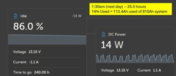

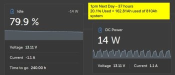

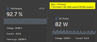

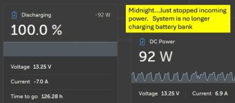

I wanted to figure out just how much power our Norcold 12 refrigerator uses in 24-36 hour period.
With our Alliance 340RL parked in our barn, so it is getting no solar power, I turned the Victron system off, so it was no longer charging the RV or creating AC power.
Of course refrigerators don’t run/cool 24hrs a day, so you will see times with just over 1.1 amps being drawn and other times with 6.9 amps being drawn. It was 85 degrees as a high in the barn and 55 degrees for the low overnight
I was a bit surprising to see the Norcold frig used over 113.4Ah in 25.5 hours…and then almost 163Ah after 36hrs. Test done on 810Ah of Lithium batteries from 4 year old Battle Born batteries
Of note...there are tiny vampire DC draws that I did not turn off…stuff like LED on radio, Co2 detector, etc

Thanks for sharing those detailed numbers—it’s really helpful to see real-world usage tracked over time. The Norcold pulling around 113Ah in just over a day and then 163Ah over a day and a half definitely gives a clearer picture of what to expect when running off batteries alone, especially without any solar input.
It also shows how much those temperature swings (85° high / 55° low) can impact cycling. Your note about the small “vampire” draws is a good reminder too—those little background pulls like CO₂ detectors and LEDs do add up over time.
With your 810Ah Battle Born setup, it’s good to know the fridge could realistically run for several days, but it also highlights how quickly power can drop if solar or shore power isn’t available.
Really appreciate you taking the time to test this—it’s valuable info for anyone trying to plan battery capacity vs. refregirator run time in similar conditions.
