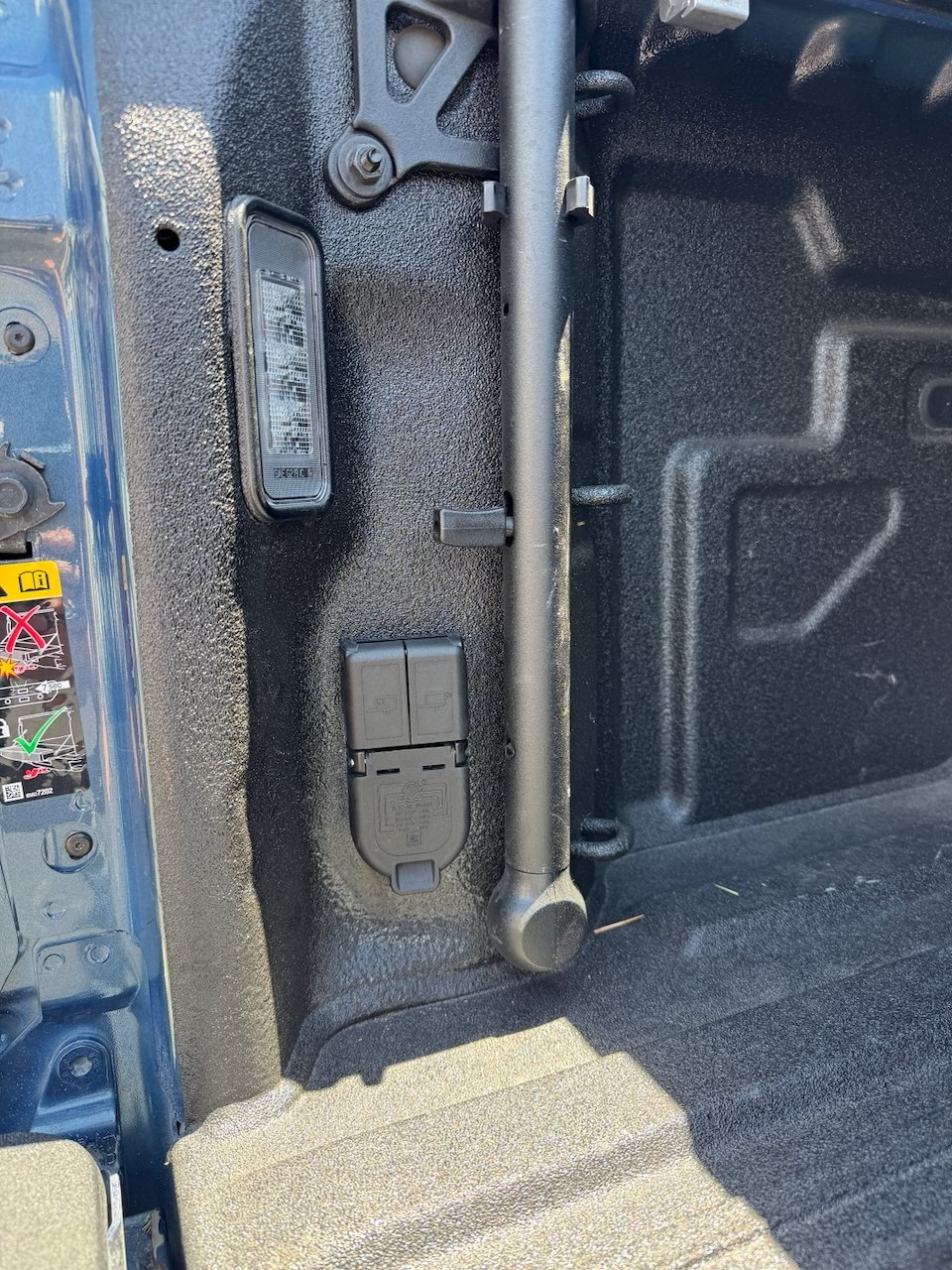

I wasn't sure I wanted it to come through the pin box, since I plug it into the bumper and didn't want it flapping against the tailgate. As of now, I have it running along the frame and just coming up from below the front compartment. Also, I'm not sure our wire chase runs to the battery compartment. If it's the black pipe in the photo below, it seems to sit above the furnace area.

I plugged mine into the bumper. First trip out the end twisted off the cable. Leaving the connector still plugged into the bumper and the cable flapping. I would recommend swapping your plug on the bumper with the one in the bed. That way you could come out through the pin box and plug into your bed. I am moving mine. Others in this chain somewhere have moved the plug to the bed. I am hoping for better results with the cable end this go around. Good luck.
We'll keep an eye on that. It worked for us for several months with our previous 5th wheel. Hopefully our luck will continue. I don't have the confidence to start relocating wiring in the truck. :)
